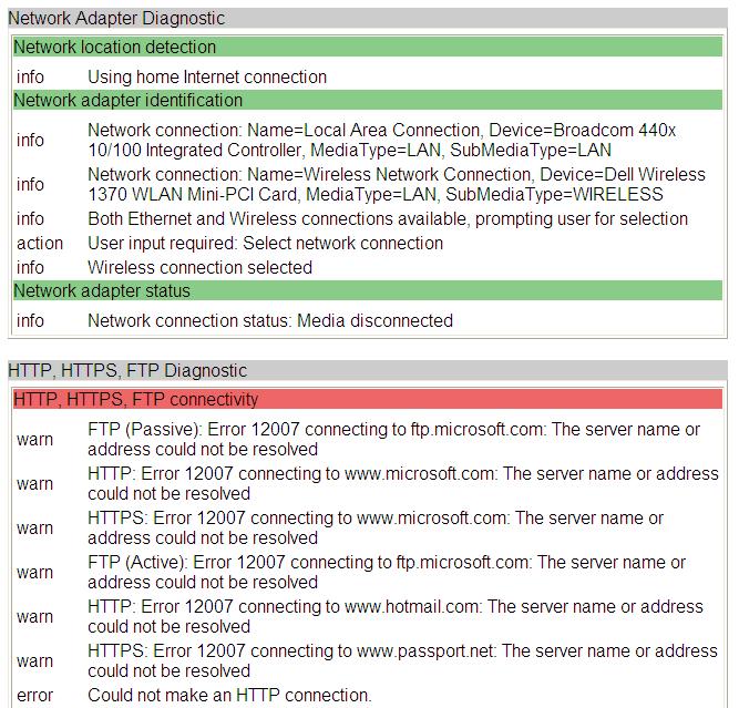

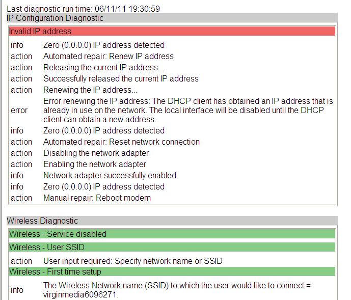

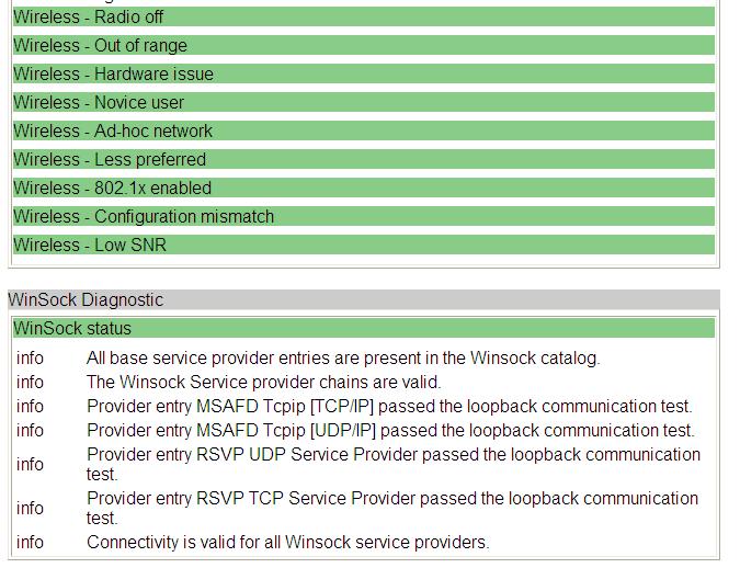

Attached are some diagnostics which I stumbled across at one stage, it is double dutch to me but maybe someone could analyse it and relate to what I have posted as it may identify the real issue.
