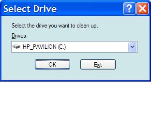

When I do the above I get this
🖼Click to load external image (Posted Image)
I do not find the System Restore box.
Is there another way to get to this system restore?
  • Go to Start > All Programs > Accessories > System Tools and click "System Restore".
  • Choose the radio button marked "Create a Restore Point" on the first screen then click "Next". Give the Restore Point a name then click "Create".
    • The new point will be stamped with the current date and time.
      Keep a log of this so you can find it easily should you need to use System Restore.
  • Then go to Start > All Programs > Accessories > System Tools > Disk Cleanup
  • disk cleanup will then calculate how much space you will be able to free up on C: > when it's done the Disk Cleanup window will open.
  • Click the "More Options" Tab.
  • Click "Clean Up" in the System Restore section to remove all previous restore points except the newly created one.
OK, I got. CatByte, Thank you for all your help. It is greatly appreciated as is your patience and your very professional manner. And of course your knowledge is excellent. But you probably already knew that. I’ll check out your suggestions for fire walls etc. Thank you again. Glen
