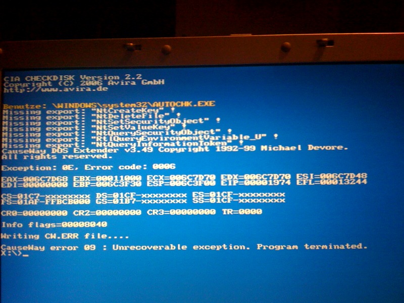

Will check that out now, thanks. In the meantime, I was able to get that tool you gave me to run a diagnostic, and finally got this. (I've uploaded the pic of the screen) However, not sure it ran through it's paces normally, but it was the only time I was able to get any kind of report, otherwise always unable to run. Not sure if this helps at all, but here it is. Thanks, get back to you after downloading and scanning the update. Talk w/you soon.

Posted 03 February 2011 - 04:07 PM
Hi lthsinc,
Was this using Xpud?
Please check on the USB device for a file named cw.err. I'll see what I can find out about the messages in the screenshot you posted.

The causeway error messages may be related to a ram issue. We can run a ram test and see what happens. A good time to run this overnight as it can take some time.
