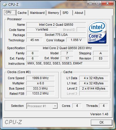

Hi again Shane,
That's great news that your system is running good. I'm at a loss as to why your system is not correctly identifying the CPU, but I am glad CPU-Z is reporting it. Before I comment further on your CPU-Z results, those pictures would be really good for me to see. I'll wait until you attach and upload them before commenting further.

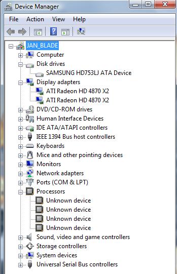

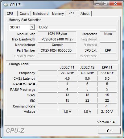

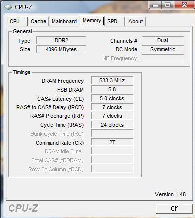

Posted 20 October 2008 - 08:36 PM
Hi Troy, Ive attached the screenshots from CPU-Z and ive also attached a screenshot of the Vista device manager where it states under Processor "Unknown Device". Ive also included screenshots of the Memory detection from CPU-Z. It states under "Maximum Bandwidth" "PC2-6400-400MHz". My RAM installed is PC2-8500- 1066MHz, so shouldnt it state in CPU-Z that the Max Bandwidth is 1066MHz??? Thanks for you input again Troy, sorry for the 'Newbie' questions.
Edited by shane_vt87, 20 October 2008 - 08:44 PM.

Hi there, It does look like your motherboard could do with some "finetuning" to fully realise your memory's capabilities. First up, can you please post a link to your exact set of memory - the manufacturers support page would be perfect. Cheers Troy

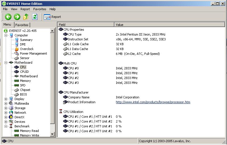

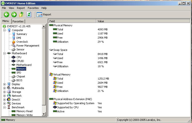

Hi Troy, I installed Everest Home Edition but it doesnt detect the 'SPD'. It only detects the actual phyical memory in my system. Nor does it detect the correct CPU- it detects the Intel Xeon 3360, which is based on the same specs and architecture but is a server model of my cpu. I tried generating a "report" in Everest, but that didnt work. Ive included the screenshots below. Thanks again for your help
