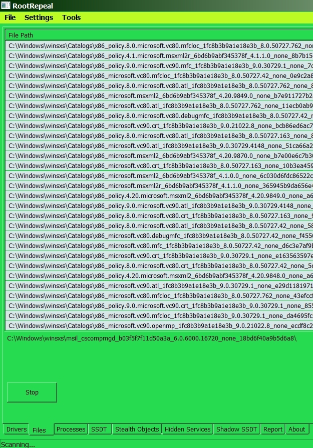

Well… so far, this is not putting my mind too much at ease: I downloaded RootRepeal, as you instructed, and extracted it on my desktop. I got it started running, and, since you suggested that it might take a while to complete its scan, I turned my attention away from the computer for a bit. Only a little while later, I heard one of those Windows alert "chimes", and glanced toward the computer just in time to see the program closing itself, without giving me a chance to save a report.
Thinkging I might have done something incorrectly, I tried setting it up to run again. This time, I decided to pay much closer attention to the running scan, to see if I could observe what it was doing when things went wrong. It blew through the scan of the drivers faster than I could watch, then moved on to the files tab for that portion of the scan. After scanning for a while, it seemed to take a particularly long time scanning a file with a long complicated name in the windows\winsxs\ directory, but the chime sounded and the program closed before I could jot down the entire file name.
Sometimes, I'm nothing if not stubborn. I set RootRepeal up to run another time, and this time, when it got to the file that's causing it to crash, I was able to grab a screen shot (see attached). I know you wanted to set my mind at ease, but after both GMER and RootRepeal were prevented from completing their scans… :smack:
Anyway, I'm glad you're willing to be patient with me… still can't thank you enough for all the help.
Those are all part of the Vista operating system.
I wouldn't be overly concerned about it.
